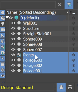

  • Toggle object and layer visibility by clicking the eye icon after selecting the layer. In the following image, when the Plants layer is selected (highlighted) and then hidden with the eye icon, all of its children or members of its group (Foliage003, etc.) become invisible.
    Note: The eye icon has no connection with scene lighting; it merely indicates whether an object or layer is visible (yellow) or not (gray).
