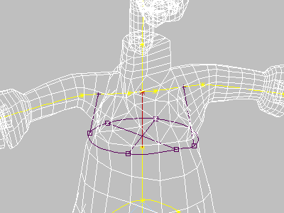

To create a tendon from the spine to the upper arm, go to the Tendon sub-object level. Select a spine link. In the Insert Settings group, click to turn on Insert, and then click the selected link to position the tendons. A tendon cross section is added to the link. Turn off Insert.
In the Selection Level group, turn on Cross Section. Using the Rotate tool (on the Main toolbar), rotate the cross section so its control points are in useful locations. In the Tendon Parameters group, use the Radius spinner to scale the cross section radius so the control points fall close to the surface of the skin.
In the Selection Level group, turn on Control Point. Select a control point on the spine tendon's cross section, click Attach, and then click the arm link. A tendon stretches from the spine to the arm.
Finally, adjust the values of Pull, Pinch, and Stretch to refine the movement of the skin.
Tendons connecting upper chest to arms
