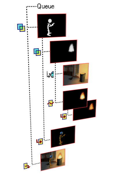

A video post queue can include scene geometry, background images, effects, and masks for compositing them.
The result of video post: a composited frame
