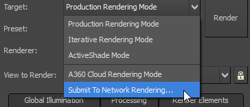

To run a cloth simulation with a networked render farm:
    A complex cloth simulation can require extensive computation and take a long time. Cloth includes commands that make it easy to run a simulation on a networked machine (part of a render farm), freeing up your machine for working on other parts of the scene.
  1. Set up the simulation.
  2. For each cloth object in the simulation, select the object, and then on the Selected Object rollout click Set and specify a path and file name for the cache.
    For best results, specify a mapped drive and turn on Force UNC Path. This specifies the path using the Universal Naming Convention so that it can be found by all computers in the network. Also, it's probably a good idea to keep all the cache files in the same directory.
  3. On the Simulation Parameters rollout, turn on Sim On Render.
  4. Save the scene file.
  5. Open the Render Setup dialog.
  6. From the Render Setup dialog Target drop-down list, choose Submit To Network Rendering.
  7. 3ds Max opens the Network Job Assignment dialog. Submit the job to a single Server.
    Unlike rendering, network Cloth simulation cannot be split up among multiple Server machines.
    Note: You needn't render the entire animation to trigger the cache creation; a single frame suffices.
    As soon as the Server machine starts the render, it begins computing the simulation and saving it to disk. At any point you can load the simulation in its current state from the cache file to check its progress by clicking the Load button.
