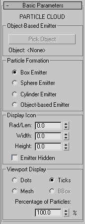

Basic Parameters rollout
Object-Based Emitter group
Lets you select a renderable mesh object to use as a particle emitter. This object is used only when the Object-Based Emitter option is chosen in the Particle Formation group.
- Pick Object
- Click this, and then select a renderable mesh object to be used as a custom emitter.
- Object
- Displays the name of the picked object.
These options let you specify the shape of the emitter.
- Box Emitter Chooses a box-shaped emitter.
- Sphere Emitter Chooses a sphere-shaped emitter.
- Cylinder Emitter Chooses a cylindrical emitter.
- Object-Based Emitter Chooses the object selected in the Object-Based Emitter group. Note: With regard to animation of the object-based emitter, the particles will properly fill a deformed object at frame 0, but they can't stay with the emitter while it's moving. If the emitter moves in a straight line, this can give the appearance of the cloud moving with the emitter.
Display Icon group
These options let you adjust the dimensions of the emitter icon when a custom object is not used as an emitter. When a custom object is used you can still resize the "Fill" icon using these options.
- Rad/Len
- Adjusts the radius of a spherical or cylindrical icon, and the length of a box icon.
- Width
- Sets the width of a box emitter.
- Height
- Sets the height of a box or cylindrical emitter.
- Emitter Hidden
- Hides the emitter.
