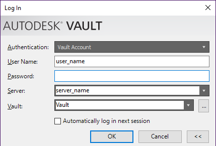

Use the Server menu when you work with the Vault.
- Log in
Displays the Vault Log In dialog. Enter your authentication, user name, password, server name, and vault name, and then click OK. After entering a server name, you can click the ellipsis (...) button display all available databases and choose one from the dialog.
You can log in automatically in future sessions without having to use the Vault Log In dialog by enabling “Automatically log in next session.” This also turns on Options
Log in using saved settings.
The login settings are stored in the file plugcfg\ATSVaultLogin.ini in the 3ds Max root installation folder.
- Log out
Logs you out of the database.
- Options
Opens the Vault Options dialog, where you can view the working folder and specify a new one (click the Change button). Available only when logged in.
Attention: The working folder is a folder on your local drive that mirrors the top-level folder of the provider database structure.You can log in automatically in future sessions, bypassing the Vault Log In dialog, if you turn on “Log in using saved settings.” This also turns on Vault Log In
Use these settings next session.
- Launch Provider
Opens the Vault Login dialog.
