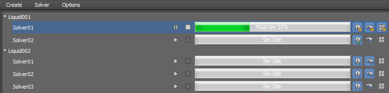

Interface
Management System Area shown with two liquid objects and five active solvers.
Menu bar
Use the Menu bar to manage objects, solvers, and caches, as well as change the window layout and monitor the simulation.

Solver Area
Use the Solver Area to manage liquids and solvers, start and stop solves, monitor sim progress, and select simulation components.

Simulation Controls
Use the simulation controls to solve selected components and monitor their progress. You can solve liquid, foam and the cache mesh at the same time, or solve the liquid first and then the foam and/or cache mesh.
| Click: | To: |
Start the solve. |
Pause the solve. |
Stop the solve. |
Solve the liquid component. |
Solve the foam component. |
Generate the mesh component. |
Enabled components are shown in light blue. Components that are not completely solved show a yellow clock, and completed solves show a green checkmark.
