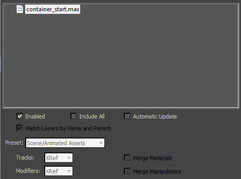

Record List controls
- Enabled
- Turn off to disable all XRef objects referenced from the MAX files currently highlighted in the XRef Record list. Disabled external reference files and objects are are not loaded into memory. Default=on.
- Include All
- If you turn this on before you add an XRef record, all the objects in the source file are included as external references. This option bypasses the XRef Merge dialog. Default=off.
If you create an XRef record when Include All is turned off, only those entities selected for that XRef record (in the XRef Merge dialog) will be a part of the record: any new objects created in the source file will not be part of the record. If Include All is turned on when you create a record, any new objects created in the source file will be included in the XRef record when you reopen or Update the main file. If Include All is turned on before a record is updated (after the first XRef), all new objects will be included in the XRef, but turning if off later will not remove them from the record.

- Automatic Update
- When on, changes made to externally referenced objects, controllers, materials, and manipulators in the source scene are automatically updated in the main file as soon as the source file is saved. There's no need to click Update. Default=off.
Note: You can change the state of Enabled, Include All, and Automatic Update after a record is created.

- Preset drop-down list
- These options let you choose how to treat the XRef'd data.
You must choose this option before you add the XRef record (source) file.
- Content References only geometry information.
Recommended when you are adding only geometry content; for example, from a library of geometric models.
- Static Assets References both geometry and transform data. Material updates are stored in the local scene.
Recommended for shading and lighting workflows.
- Rigs to Animate References geometry and rigging data. Animation and material updates are stored in the local scene. Source file updates to geometry or rigging can be inherited by the local scene.
Recommended for animation workflows.
- Scene/Animated Assets (The default.) References geometry and animation data. Material updates are stored in the local scene. Source file updates to geometry or animation can be inherited by the local scene.
- Customized If the combination of Record List settings you choose does not match one of the presets, the Preset drop-down setting changes to Customized.
