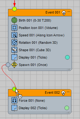

  • To wire a test to an event, drag from its test output, the green circle that 4 sticks out to the left of the test, to the event's event input, which sticks out from the top. You can drag from the input to the output, as well. Similarly, you can wire a global event to a birth event by dragging between the source output on the bottom of the global event and the event input.
    Wiring an event
    When the wire is ready to be connected to an input or output socket, the cursor shows a small plus-sign.
