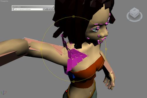

For example, the following illustration shows how the Marama rig's shoulder and upper arm have collapsed after being twisted and pulled in various directions. (Marama is one of the standard CATRigs included with CAT.)
Marama's shoulder will behave better once we finish applying the CATMuscle to her CATBones.
That happened because Marama's rigging includes no muscle objects; the skin shape is determined by the relative positions of the CATBones.
In the illustration, the purple patches are the segments of a CATMuscle that was created and shaped to use as muscles for her pectorals and shoulder. To complete the job, you would:
  • Finish parenting the segments to appropriate positions on the CATBones.
  • Drive the skinning with the CATMuscle rather than the CATBones.
