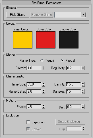

Fire Parameters rollout
Gizmos group
You must assign an atmospheric apparatus to a fire effect before you can render the effect. Use buttons in the Gizmos area to manage the list of apparatus objects.
Gizmo for the fire in the scene shown at the beginning of this topic
Pick Gizmo
Click to enter Pick mode and click an atmospheric apparatus in the scene. The apparatus displays the fire effect when you render. The name of the apparatus is added to the apparatus list.
Multiple apparatus objects can display the same fire effect. For example, torches on a wall can all use the same effect. Assign a different seed to each apparatus to vary the effect.
You can assign single apparatus to multiple fire effects. For example, one apparatus can display both a fireball and a tendril flame effect.
You can choose multiple gizmos. Click Pick Gizmo and press H. This opens the Pick Object dialog, which lets you choose multiple objects from the list.
Remove Gizmo
Removes the gizmo selected in the gizmo list. The gizmo remains in your scene but it no longer displays the fire effect.
[gizmo drop-down list]
Lists apparatus objects assigned to the fire effect.
Colors group
You can set three color properties for a fire effect using the color swatches under Colors. Click a color swatch to display the 3ds Max Color Selector.
Inner Color
Sets the color of the densest part of the effect. For a typical fire, this color represents the hottest part of the flame.
Outer Color
Sets the color of the sparsest part of the effect. For a typical fire, this color represents the cooler, dissipating edge of the flame.
The fire effect is colored using a gradient between the inner and outer colors. The dense areas of the effect use the inner color and gradually blend to the outer color near the edges of the effect.
Smoke Color
Sets the color of smoke for use with the Explosion option.
If you turn on Explosion and Smoke, the inner and outer colors animate to the smoke color. If you turn off Explosion or Smoke, the smoke color is ignored.
Shape group
You control the shape, scale, and pattern of flames within the fire effect using controls under Shape.
Flame Type
Sets the direction and general shape of flames.
  • Tendril Creates directional pointed flames with veins along their center. The flames orient along the local Z axis of the fire apparatus. Tendril creates campfire-like flames.
  • Fireball Creates round puffy flames. Fireballs are well suited for explosions.

Characteristics group
You set the size and appearance of flames using parameters under Characteristics. All of these parameters depend on the apparatus size and are interdependent on each other. Changing one parameter affects the behavior of the other three.
Flame Size
Sets the size of individual flames inside the apparatus. The size of the apparatus affects the flame size. A larger apparatus requires a larger flame size. Use a range from 15.0 to 30.0 for the best results.
Large values work best for Fireballs.
Small values work best for Tendrils.
If the flame size is very small, you might need to increase Samples to see individual flames.

Motion group
Use the parameters in the Motion group to animate the churning and rise of flames.
Phase
Controls the rate of change for the fire effect. Turn on and change the phase value at different times.
Drift
Sets how flames are rendered along the Z axis of the fire apparatus. The value is the amount of rise in units.
Low values give a slow-burning, cool fire.
High values give a fast-burning, hot fire.
For the best fire effects, drift should be a multiple of the height of the fire apparatus.
You can also animate the location and size of the fire apparatus and most of the fire parameters. For example, a fire effect can animate color, size, and density.
Explosion group
Use the parameters in the Explosion group to automatically animate explosions.
Explosion
Animates size, density, and color automatically based on the animation of the Phase value.
Smoke
Controls whether or not the explosion creates smoke.
When on, fire colors change to smoke between Phase values 100 to 200. Smoke clears between Phase values 200 to 300. When off, fire colors remain at full density between Phase values 100 to 200. Fire fades away between Phase values 200 to 300.
Fury
Varies the churning effect of the Phase parameter.
Values greater than 1.0 cause faster churning. Values less than 1.0 cause slower churning.
Set Up Explosion
Displays the Set Up Explosion Phase Curve dialog. You enter a start time and end time, and then click OK. The Phase value animates automatically for a typical explosion effect.
