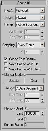

Interface
The user interface appears in the parameters panel, on the right side of the Particle View dialog.
- Use At
- Caches particle motion when playing back in the viewports, or at render time, or both. Default=Viewport. Important: Choose the Viewport/Render option only when using the same number of particles in the viewports and for rendering. In other words, the two Quantity Multiplier settings on the Emission Rollout of the global event (or Particle Flow source) must be identical. Otherwise, unpredictable results can occur.
- Update
- If you change a parameter in the particle system, the cached data might become invalid. This setting determines whether Particle Flow should update the cache automatically, or let you do it manually. Default=Always.
- Always Changing any parameter under the Cache operator's purview causes it automatically to update stored data from the start of the current range (see next parameter) to the current frame.
- Manually Updating occurs only when you click the Update button, or clear the cache and then move to a different frame.
- Range
- Sets the frame range within which the Cache operator operates. Default=Active Segment.
- Complete Particle Flow caches the entire animation.
- Active Segment Particle Flow caches only frames in the active segment, as defined by the Start Time and End Time settings on the Time Configuration dialog. This is the frame range shown on the track bar. You can also change the active segment by holding down Alt+Ctrl and dragging the track bar with the mouse—for this operation you can use the left, middle, or right mouse button.
- Custom Particle Flow caches only frames in the custom range, as defined by the Cache operator's Start Time and End Time settings (see following). Note: If you cache only part of the animation, Particle Flow calculates particle behavior in subsequent, non-cached frames using the cached data. For example, if you cache frames 0 to 50, and then jump to frame 60, Particle flow will calculate frame 51 based on the cached data, and frames 52 to 60 based on each previous frame.
- Start/End Time
- The first and last frames of the range considered for caching when Range=Custom (see above). Default=0, 30. Note: The frame range time frame is in absolute time; that is, in terms of the entire animation. If you use a Cache operator locally, and specify a frame range during which no particles are present in the event, Particle Flow won't use the cache.
- Sampling
- Determines how often the Cache operator samples and caches the animation. Default=Every Frame.
- Every Frame Particle Flow caches animation data once per frame.
- Integration Step Particle Flow caches animation data at each integration step, using the Integration Step setting as specified in the Use At setting (see above). If Use At is set to Viewport/Render, it uses lower of the two Integration Step values. For example, if Viewport is set to Half Frame, and Render to 1/8 Frame, the sampling rate would be eight per frame.
- Every Nth Frame Particle Flow caches animation data at frame intervals specified by the N value, below.
- N
- Determines the frame interval for caching when Sampling (above) is set to Every Nth Frame. Default=5.
For example, with N set to the default value of 5, the cache stores animation data for every fifth frame.
- Cache Test Results
- When caching particle data, this caches the results of test actions as well. Default=on.
This is important if Cache is used as a local operator, and the next event doesn’t have a Cache operator. For the next event to work properly, it should receive particles from the current event. Those particles result from the activity of a test action. The Cache operator can record the test activity to play it back later.
If the Cache operator is used as a global operator, there is no need to cache the test results. This is because the system has cache data for every event, and is able to jump to an arbitrary frame without the need for test results.
- Save Cache with File
- When on, Particle Flow Includes the cached data with scenes that you save to disk. This can significantly increase the size of saved files, but saves the time of recalculating the particle motion upon reloading the file. Default=off.
Normally, the cached data is saved only in disk files that you create with the Save or Save As commands. You can also instruct 3ds Max to include cached data with other types of files using the two following options.
- Save Cache with Hold
- Saves cached data in the Hold file, created with Edit menu
Hold. Default=off.
Manual Update group
These controls let you update or clear the cache manually within a frame range, or clear the entire cache.
- Update
- Calculates particle motion within the current range (defined below) and stores it in the cache, replacing any existing cached data. Available only when Range is set to Active Segment or Custom.
During the update, 3ds Max temporarily closes Particle View and displays a Cache Update Progress bar, while moving the time slider through the cached range. At the same time, by default, the animation plays in the viewports. To prevent this, and speed calculation, turn off Update Viewports.
If the cache runs out of memory during a manual update, Particle Flow halts the update operation and displays an alert. Click OK to continue, and then, if possible, increase the Limit value before updating the cache again.
- Clear
- Deletes any cached data.
After you clear the cache buffer, if you go to a different frame or change any action parameters, Particle Flow automatically caches particle motion even if Update is set to Manually.
- Range
- Sets the frame range within which the Cache operator recalculates data when you click Update. Default=Active Segment.
- Complete Particle Flow clears the cache for the entire animation. Choosing Complete makes the Update button unavailable; this option is for clearing the cache only.
To update the entire animation, set the active segment or the custom range to encompass all frames, and then use the corresponding choice and click Update.
- Active Segment Particle Flow updates the cache only for frames in the active segment, as defined by the Start Time and End Time settings on the Time Configuration dialog. This is the frame range shown on the track bar. You can also change the active segment by holding down Alt+Ctrl and dragging the track bar—for this operation you can use the left, middle, or right mouse button.
- Custom Particle Flow updates the cache only for only frames in the custom range, as defined by the Start Time and End Time settings (see following).
- Start/End Time
- The first and last frames of the range that's updated when Range=Custom (see above). Defaults=0, 30.
- Update Viewports
When on, the animation plays in the viewports during manual updating of the cache. Turn this off to disable playing the animation in the viewports during manual caching; this can speed up the caching process, especially with large or complex particle systems. Default=on.
Memory Used (K) group
The Cache operator stores data in system memory; you can specify an upper limit for the amount of memory it uses. If the Limit setting and the amount of cached data exceeds the available free memory, the computer system might use virtual (hard disk-based) memory instead, which slows down the caching. If Particle Flow fills the cache, any remaining frames are calculated on the fly.
This group also lets you monitor the amount of memory used for caching data.
- Limit
- The maximum amount of system memory used to cache particle data, in kilobytes. Default=100,000, or 97.6 MB.
- Total
- The amount of memory currently used by the cached data, in kilobytes. Read-only. Note: Even animation frames with no particles will probably consume a certain amount of cache memory. The reason for this is that the cache also stores states for randomly calculated values such as Variation, to ensure that particle activity is consistent across a rendering network, and with machines that might not have regular access to all frames.
- Current Frame
- The amount of memory used by the data cached for the current frame, in kilobytes. Read-only.
