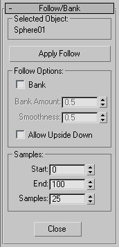

Interface
Selected Object group
Displays the name of the current selection. If more than one object is selected, "Multiple Selected" displays.
Apply Follow
Click to apply the settings and generate rotation keys. Each time you click this button, rotation keys in the specified range of frames (set in the Samples group) are deleted and regenerated.
Follow Options group
Contains the parameters that specify whether or not to use banking, and the banking settings.
Bank
Turn on to cause the objects to bank as well as follow the trajectory.
Bank Amount
Adjusts the amount of the banking to one side or the other, depending on whether the value is positive or negative.
Smoothness
Controls how rapidly the roll angle changes as an object moves through bends in the trajectory. Smaller values make an object more responsive to subtle changes in the curve while larger values minimize jerkiness.
Allow Upside Down
When off, avoids the situation where an object flips when going around a vertically oriented path. When on, allows the object to flip. Default=off.
Samples group
Specifies the range of frames over which rotation keys are generated, and the number of keys to be generated.
Start
Specifies the first frame rotation keys are generated.
End
Specifies the last frame rotation keys are generated.
Samples
Specifies the number of rotation keys to be generated in the specified range.
