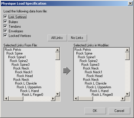

This dialog appears after you have chosen a Physique (.phy) file to load. It lets you specify which information you want to obtain from the file.
  • Select an object that has the Physique modifier applied to it. > Modify panel > Physique rollout > Click (Open Physique (.phy) File). > Choose a file. > Physique Load Specification dialog

At the upper left of the dialog are checkboxes that let you specify which kind of data to load. Turn off a checkbox to avoid loading that kind of data.
Link Settings
Loads link parameters. Default=on.
Bulges
Loads cross sections and bulge angles. Default=on.
Tendons
Loads tendons. Default=on.
Envelopes
Loads envelopes. Default=on.
Locked Vertices
Loads locked vertices.
All Links
Selects all links to load.
This button is enabled only if the number of saved links equals the number of open links. Click to select all links in both lists. If All Links is disabled, you must choose links by hand. Click the name of a link in a list to select it. Before you click OK, the number of links to load must equal the number of links to update.
No Links
Deselects all links in both lists.
After deselecting all links, you must select the links to load and to update, before you click OK.
Selected Links From File and Selected Links In Modifier
At the left of the dialog is a list of the links that were saved in the file, and at the right is a list of links in the currently open Physique skin and skeleton. You can choose which links to update with the saved data.
