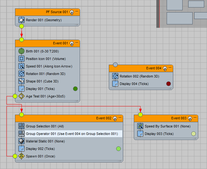

In the Particle Flow network shown above, all particles in Event 01 that pass the Age test are directed to Event 02, but only those that were selected by the Group Selection operator in Event 02 will use the operators in the Rotation event. Then all particles that flowed to Event 02 (including both the particles selected with the Group Selection operator, and those not selected) are directed to Event 03 via the Spawn test.
