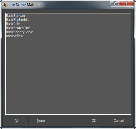

Update Scene Materials from Library
Uses the library to update materials in the scene. If the scene contains materials that have the same name as materials in the library, choosing this option opens the Update Scene Materials dialog.
To update a material from the library, highlight the material and then click OK.
  • [material name list] Lists all materials that have the same name in the library and in the scene.
  • All Highlights all materials in the list.
  • None Removes highlighting from all materials in the list.
If no scene materials share a name with library materials, 3ds Max displays a warning to that effect.

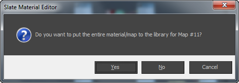

If you select a subordinate node (for example, a map or a sub-material) without selecting its parent, 3ds Max asks if you want to include the parent in the library:

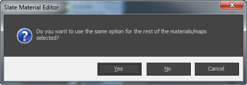

If you have selected multiple subordinate nodes, then after you respond to this dialog a second dialog asks whether you want to apply the same choice to all further selections:
