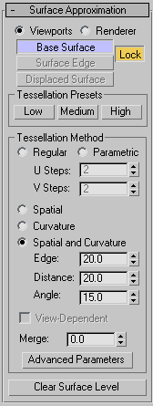

The Surface Approximation rollout controls how surface sub-objects in the NURBS model are approximated for purposes of rendering and viewport display. NURBS can be approximated differently in viewports and in the renderer. Typically you want viewport display to be clear and quick, while you want rendered display to be smooth, accurate, and "realistic." However, the approximation you choose for viewports creates a mesh, and the kind of mesh you choose can affect the behavior of modifiers that you later apply to the NURBS model.
The first two controls on this rollout are radio buttons for selecting the kind of display output, viewport or renderer, these parameters control.
Surface approximation parameters are not animatable.

  • Viewports When chosen, the rollout affects how surfaces in the NURBS object are displayed interactively in viewports, including shaded viewports, and by the preview renderer.
    The Viewports surface settings are also used when you apply a mesh modifier such as Mesh Select to the NURBS object. This is important because the modifier can affect the scene's geometry.
  • Renderer When chosen, the rollout affects how surfaces in the NURBS object are displayed by the renderer.
The next cluster of buttons lets you choose which portions of the geometry are affected by the surface approximation settings.
Base Surface
Settings affect the entire surface. This is the default.
Surface Edge
Turn on to set approximation values for tessellating surface edges that are defined by trim curves. With Lock turned off, the surface and edge tessellation values are independent of each other.
For object-level surfaces, this is unavailable unless Lock (described below) is turned off.
Displaced Surface
Turn on to set a third, independent approximation setting for surfaces that have a Displacement map applied to them. Available only when Renderer is chosen.
Using a preset approximation setting (in the Presets group box) should give you faster results for displaced surfaces.
Lock
(for object-level surfaces only) Locks the Base Surface settings to the Surface Edge settings. In other words, surfaces and surface edges have a relational tessellation setting unless Lock is turned off. Default=on.
Tessellation Presets group
Lets you choose a preset low, medium, or high quality surface approximation. While a preset is chosen, the values it uses are displayed on the Tessellation Method rollout.
Preset values are saved in the 3dsmax.ini file. You can customize the preset values by using the Surface Approximation utility.

Tessellation Method group
The controls in this group affect the display of the NURBS surface in viewports if you have chosen Viewports above, or by the renderer if you have chosen Renderer above. You can choose between five algorithms. Each approximates NURBS surfaces by tessellating them in a different way.
Generally speaking, if the preset values you have chosen give good results, you don't need to adjust the controls on this rollout. Adjust them if you encounter problems with the preset alternative.
