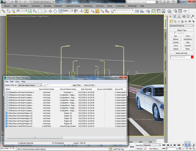

    The Imported Object Manager panel provides an overview of all imported geometry. From this panel you can update all imported data in a single operation, and check the status of imported data to see at a glance whether your visualization is out of step with your source design data.
