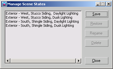

Manage Scene States Dialog
The Manage Scene States dialog is a modeless dialog where you can select, save, rename, and delete scene states.

The dialog lists all the scene states that are saved in the MAX file.
Save
Opens the Save Scene State dialog where you enter a name for the current scene state. To select a contiguous range of entries, drag or Shift+click. To select noncontiguous entries, use Ctrl+click.
Restore
Opens the Restore Scene State dialog for the selected scene state.
Rename
Opens the Rename Scene State dialog for the selected scene.
Delete
Deletes the highlighted scene states without first warning you if you are sure you want to delete the scene. To select a contiguous range of entries, drag or Shift+click. To select noncontiguous entries, use Ctrl+click.
Close
Closes the Manage Scene States dialog.
