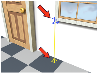

Tape provides an on-screen "tape measure" for determining and setting distances. The tape is composed of two named objects, in the same way targeted lights and cameras are. By default, these are named Tape### and Tape###.Target (the ### is a three-place number). The tape and target icons are connected by a line representing the current distance between them.
Using a tape helper to measure the distance from floor to window frame.
You can drag a length (the default), or enter a specific length by turning on Specify Length. You can snap or align either end of the tape or link to objects in your scene. Deleting either end deletes the tape.
