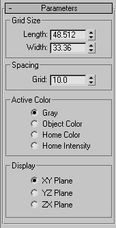

In the Parameters rollout of each grid object is a Display group with three options: XY Plane, YZ Plane, and ZX Plane. These determine which of the three planes of the grid object is displayed in the viewport.
When you activate a grid object, the displayed plane is the construction plane for all viewports. When you create a grid viewport, you can choose from one of six orthographic views (Front, Top, Left, and so on), or you can choose a special Display Planes grid viewport. (When you press the G key to create a grid viewport, the Display Planes type becomes the default.) The Display Planes type of grid viewport always displays the plane chosen by the three option buttons under Display. Thus, as you switch between XY Plane, YZ Plane, and ZX Plane, the view through the grid viewport switches accordingly, and objects created in that viewport are created on the displayed plane.

Interface
Grid Size group
Sets the overall size of the grid object. This size determines the extents of a viewport set to the grid object. It doesn't affect the useful limits of the grid, which extend infinitely.
- Length/Width
- Specifies the length and width of the grid.
Grid Spacing group
- Grid
- Specifies the size of the smallest square in the visible grid. This setting appears on the status line when the grid is activated.
Note: You can set Grid Spacing when a grid is selected, but you won't see the grid spacing until the grid is activated.
Active Color group
Determines the color used to draw the grid in viewports when it's not selected.
- Gray The active grid object is two shades of gray.
- Object Color The main grid lines use the assigned object color, while the secondary lines use a lighter intensity.
- Home Color The grid object uses the home grid color assigned via the Customize User Interface dialog.
- Home Intensity The grid object uses the grid intensity settings assigned to the home grid in the Customize User Interface dialog.
Display group
- XY Plane, YZ Plane, ZX Plane
Determines which of the three planes of the grid object are displayed in the viewport.
