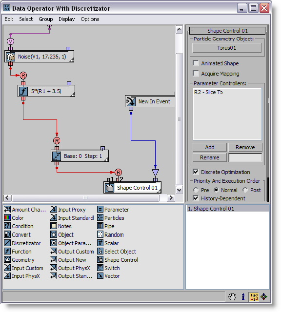

Data View serves as the command center for the Advanced Data Manipulation tools in Particle Flow. The basic operation of Data View is similar to that of Particle View: You start to build a data flow by dragging suboperators from the Depot at the bottom of the dialog into the main window. You access a suboperator's parameters by clicking it so its rollout appears on the right side of the dialog. And you create the actual flow, or schematic, by connecting suboperators, dragging between the output connector of one and an input connector or filter connector of another.
However, not all suboperators need to be physically connected; they can also be logically connected via Channel buttons, such as Particles suboperator Weight Data Channel. In these cases you click the button and then choose the channel from the list in the Select Data Channel dialog that opens.

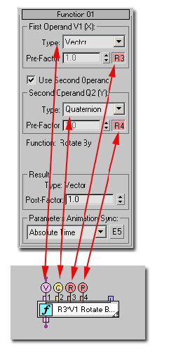

The data inputs appear on the top of the suboperator, starting at the left side. Each input is numbered to correspond to the corresponding parameter in its rollout, and has two indications as to its data type: a letter and a color. For example, an input for vector data is violet, and for quaternion data is yellow. For a full list of the data types and their respective color codes, see Data Types.
Suboperator with input connectors (below) and related parameters (above)

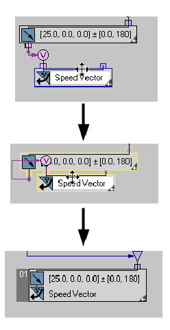

Data diagrams in Data View can quickly become very complex. To simplify the visual flow, you can combine suboperators physically into solid blocks. To do this, simply drag a suboperator on top of another to which it is wired. When yellow outlines appear around both suboperators, release the mouse to combine them into a block. You can remove a suboperator from a block simply by dragging it away from the block; release the mouse when the yellow outlining disappears.
Top: Start dragging a suboperator toward a connected one.
Center: When the yellow outlines appear, release the mouse button to combine them into a block.
Bottom: The block has a tab on the left side that you can use to manipulate it.
Important: You can combine two suboperators into a block only when the output of one is wired to the input of the other, and the latter has no other inputs. Effectively, this means that you can wire only single-input suboperators. As long as there is a continuous single-wire stream, you can combine any number of suboperators into a single group.

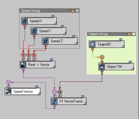

A different way of combining suboperators that has no logical restrictions is with groups. Grouping in Data View is similar to grouping objects in 3ds Max. To create a group, select some suboperators and then choose the Group command from the Data View Group menu or right-click menu.
Some additional points about groups:
  • You can add a new suboperator directly to a group by dragging it into the group window from the Depot.
  • If you drag a suboperator in a group toward the edge of the group window, the window expands to contain the suboperator.
  • To place a group window in front of another group window, drag the former over the latter.
Groups in Data View

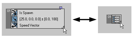

Each suboperator and block has a small arrow at its bottom-right corner. Clicking this arrow toggles the maximized/minimized state of the item. If it's maximized, the arrow points left; if it's minimized, the arrow points right. As with combining suboperators into blocks, minimizing helps reduce clutter in the Data View interface.
