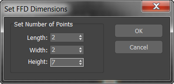

- On the FFD Parameters rollout
Dimensions group, click Set Number Of Points.
- In the Set FFD Dimensions dialog, set the parameters as follows to set the number of control points for the lattice used to deform the structure:
- Length=2
- Width=2
- Height=7
