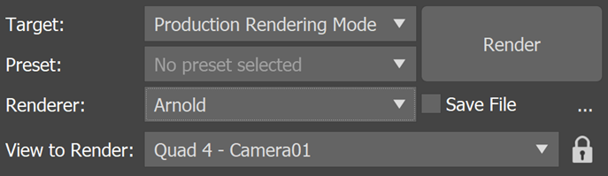

  2. At the top of the Render Setup window, set Renderer to Arnold.

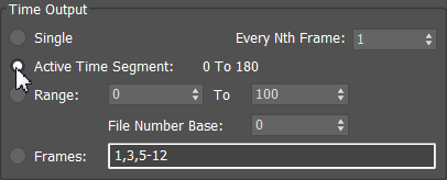

  3. In the Time Output group, choose Active Time Segment. (If you left the setting at Single, just the currently displayed frame would render.)

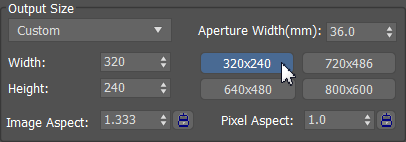

  4. In the Output Size group, change the default (640 x 480) to 320 x 240.
    This smaller size has only one-quarter the area of the default, making it much faster to render.

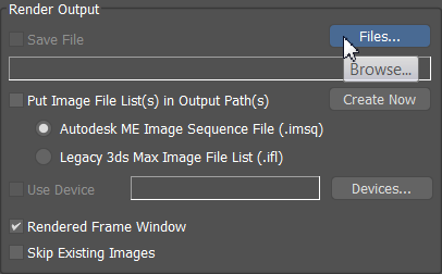

  5. In the Render Output group, click the Files button. (You might have to scroll down in order to see this control.)
  6. On the Render Output File dialog, name your animation mybattlefield_attack.avi. Click Save to save the animation to the default folder (usually \renderoutput).
    Warning: You must either add the extension .avi in the file name, or else select AVI as the file type. If you don't tell the program what type of animation format to save in, the rendering won't work.

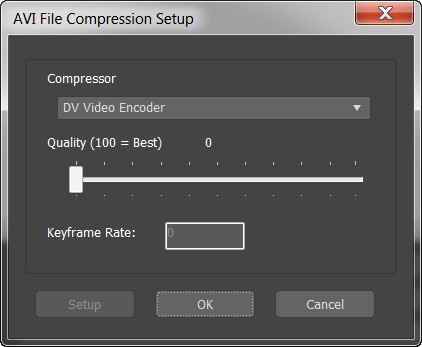

    3ds Max opens a AVI File Compression Setup dialog.
  7. Click OK to choose the default settings.
    Note: You can use the Compressor drop-down list to choose a particular video compressor, or codec. The available choices depend on your system setup. Many codecs let you use the Quality slider to adjust the quality of the output (primarily the output resolution). For the default DV Video Encoder, this control is not available.
    On the Render Setup dialog, Save File is now selected and the output field shows the location of mybattlefield_attack.avi.
  8. At the top of the Render Setup dialog, set the View to Render option to Camera01.
    Always check to be sure you’re rendering the right viewport.
