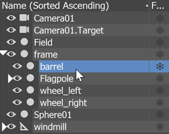

  2. If the Scene Explorer window is not already open on your desktop, on the main menu click Tools > Scene Explorer.
  3. In the Scene Explorer to the left of the viewports, expand the frame entry if you need to, and then click the barrel entry to select the barrel object.
    Tip: By default, the Scene Explorer panel appears to the left of the viewports, but if it has been hidden, you can press the H key to display a floating version of the Explorer.

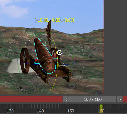

  4. On the main toolbar, click to activate (Select And Rotate).
  5. In the Camera viewport, rotate the barrel on its X axis by –10 degrees.
    As you modify the barrel rotation, the axis values update in yellow.
