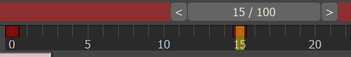

    If you drag the time slider between frame 0 and frame 15, you will see that 3ds Max has animated the fall of the basketball. Red boxes appear on the timeline at both frame 0 and frame 15: These represent keys that 3ds Max created when you moved the ball.
    Keys appear on the timeline at frame 0 and frame 15.

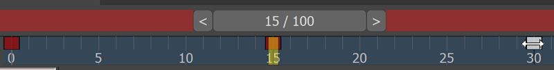

  1. On the timeline, click the key at frame 0 to select it.
  2. Hold down the Shift key, then drag the key from frame 0 to frame 30.
    Shift+drag is a general method for cloning keys on the timeline. (Dragging a key without holding down Shift simply moves the key.) Now at frame 30, the ball is in precisely the position it was in at frame 0.
