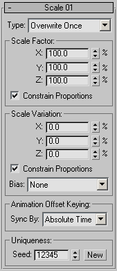

The user interface appears in the parameters panel, on the right side of the Particle View dialog.
Type
The scaling Type setting includes options that let you scale particles once in an event or repeatedly, and apply scaling as an absolute or relative factor.
  • Overwrite Once (The default.) Sets the scale one time only as an absolute percentage value, disregarding any previous scaling.
    To produce a range of different birth sizes, and specify the scaling explicitly, use Overwrite Once with animated scale factors.
  • Inherit Once Sets the scale one time only as a percentage of existing scaling. The existing scaling should be specified with a previous Scale operator, the Scale setting in the Shape operator, or a Shape Instance operator.
    For instance, if you previously used Scale with Overwrite Once to scale particles' birth size within a range, and then want to scale them to half their previous size, use Inherit Once and set Scale Factor to 50%.
  • Absolute Sets the scale continuously, while the particle is in the event, as an absolute percentage value, disregarding any previous scaling.
    Use Absolute if you want to animate the particles' scale explicitly.
  • Relative First Sets the scale continuously, while the particle is in the event, as a percentage of existing scaling. The existing scaling should be specified with a previous Scale operator, or a Shape Instance.
    Use Relative First when you want to scale the particles relative to the scaling at which they enter the event, and optionally animate the scaling, or before a Relative Successive operator.
  • Relative Successive Scales the particles continuously, relative to scaling set earlier in the same event.
    Note: Always precede Relative Successive in the same event with an operator that modifies the scale channel all the time, such as a Scale operator set to Absolute or Relative First, or a Shape Instance operator with the Scale checkbox turned on (it's on by default).
Scale Factor group
The operator performs scaling on each particle's local axes. It can scale particles on a single axis or on any combination of axes.
X/Y/Z
Sets the scaling as a percentage of the particle's current size. To scale uniformly, turn on Constrain Proportions, and then change any axis setting. Range=0 to 10000000. Default=100.
When on, retains the current ratio of scale factor settings, so that changing any axis setting changes all of them. Default=on.
Scale Variation group
X/Y/Z
Sets the scaling variation as a percentage of the particle's previous size. To scale uniformly, turn on Constrain Proportions, and then change any axis setting. Range=0 to 100. Default=0.
When on, retains the current ratio of scale variation settings, so that changing any axis setting changes all of them. Default=on.
Bias
Lets you choose how to distribute the scaling variation within the specified range or ranges. Default=None.
  • None No bias; scaling variation is distributed equally through the range.
  • Centered Scaling variation is concentrated near the middle of the range; that is, at 0.0%.
    With this choice, scaling will occur more frequently with low percentage values than with ones near the values you set. In other words, most scaling variants will be close to the specified scaling value.
  • Towards Minimum Scaling variation is concentrated near the lower end of the range (base-variation); that is, most scaling variants will be smaller than the scaling value.
  • Towards Maximum Scaling variation is concentrated near the upper end of the range (base+variation); that is, most scaling variants will be larger than the scaling value.
Animation Offset Keying group
If you animate the Scale Factor or the Scale Variation settings or both, Particle Flow can begin applying this animation to all particles as of the start frame of the animation or the first frame of the current event, or to each particle based on its age. For instance, if you set Sync By to Particle Age, and set Scale Factor keys at frames 0 and 30, then Particle Flow will animate the scaling factor for each particle between its birth and its 30th frame of existence, if the particle is in the scaling event or a prior event. Following this example, any particle that has already reached its 30th frame of existence before reaching the event will enter the event fully scaled. That is, Particle Flow will apply the Scale Factor value that you set at frame 30 to each particle aged 30 or above at the moment it enters the scaling event. However, any particle that leaves the scaling event before reaching age 30 will stop scaling as of its exit frame. In other words, with respect to particles in other events, animation of action parameters is retroactive, but not post-active.
Alternatively, if you set Sync By to Absolute Time, the scaling is animated from frame 0 to frame 30 of the animation, regardless of particle age, and even if no particles are in the event at that time. Or, if you set Sync By to Event Duration, the scaling animation is applied to each particle as of the time that it enters the event.
Note: With the Overwrite Once and Inherit Once scaling types, scaling always occurs with respect to the entire animation; that is, in Absolute Time mode. Thus, when either of those scaling types is in effect, the Sync By setting is unavailable. Also, if you animate Scale Factor or Scale Variation when using Overwrite Once or Inherit Once, it doesn't cause scaling animation in the particles, but rather applies one-time scaling to particles born during that period. For instance, if you animate Scale Factor on all three axes from 100% to 200% over frames 0 to 30, particles born at frame 0 are normal size, particles born at frame 15 are one-and-one-half times normal size, and particles born at frame 30 (and thereafter) are twice normal size.
Sync By
Choose the time frame for applying animated parameters:
  • Absolute Time Any keys set for parameters are applied at the actual frames for which they're set.
  • Particle Age Any keys set for parameters are applied at the corresponding frames of each particle's existence.
  • Event Duration Any keys set for parameters are applied to each particle starting when it first enters the event.
Uniqueness group
The Uniqueness setting affects the randomization of scale variation.
Seed
Specifies a randomization value.
New
Calculates a new seed using a randomization formula.
