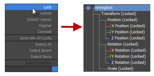

Lock an object’s transforms:
- In Session 1, open the container, then, on the Rules rollout, click the Edit button.
Track View opens showing the container hierarchy.
- Scroll down to the
wineglass item and click the Transform entry to highlight it.
Tip: As long as
(Filter - Selected Objects Toggle) is on in Track View, you can find the object faster in the list by selecting it.
- Right-click the Transform entry, and from the quad menu
top-left quadrant, choose Lock.
The Transform entry and all its children (branches and leaves) now show “(Locked)” after their names in the Track View hierarchy.
