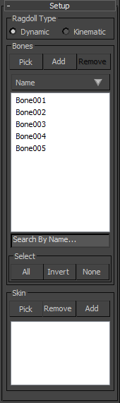

Setup rollout
Ragdoll Type
Determines how the Ragdoll participates in the simulation:
  • Dynamic The motion of the Ragdoll affects and is affected by the motion of other objects in the simulation.
  • Kinematic The motion of the Ragdoll affects the motion of other objects in the simulation, but is not affected by it.
Note: For best results, when setting a Ragdoll biped to be Dynamic, the biped should not contain any existing animation. In particular, using a biped animated with the Walk tool as a Dynamic Ragdoll can lead to unexpected results. Similarly, avoid switching individual rigid bodies of Ragdoll objects from Kinematic to Dynamic mid-simulation using the Until Frame option. In general, don't mix animation types with a Ragdoll: Either allow MassFX to control the Ragdoll's motion completely (Dynamic) or use standard animation methods (Kinematic).
Also, when using a biped as a Dynamic Ragdoll, be aware that biped constraints take precedence over the MassFX constraints imposed by the Ragdoll. For example, the MassFX simulation might tend to break a constraint to which excessive force is applied, but because biped does not permit separation of its bones, the break does not occur.
Bones group
Pick
Associates bones from the character with the Ragdoll. After clicking this button, click a bone in the character not already associated with the Ragdoll. A MassFX Rigid Body modifier is applied to each added bone.
Add
Associates bones from the character with the Ragdoll. Clicking this button opens the Select Bones dialog, listing of all the bones in the character not already associated with the Ragdoll. A MassFX Rigid Body modifier is applied to each added bone.
Remove
Disassociates highlighted bone(s) in the bone list from the Ragdoll. Removes the MassFX Rigid Body modifiers from each disassociated bone, but does not delete or otherwise modify the bone itself.
If a group is highlighted, instead ungroups the bones, creating a rigid body for each.
Name
Lists all bones in the Ragdoll. Highlight bones in this list to remove them, group them, or batch-change the rigid body settings. To highlight multiple bones, use standard Shift+click and Ctrl+click methods.
Bones are automatically sorted in ascending alphabetical order, as indicated by an upward-pointing arrow at the right end of the Name button. To reverse the sorting order, click the Name button.
Note: The list is automatically populated with any bones already associated with the character when you create the Ragdoll.
Search By Name field
Enter search text to highlight the first matching item in ascending alphabetical order.
Tip: Use the wildcard (*) key to stand in for any number of leading characters. For example, you can find Robot R Index Finger by typing * R In.
Select group
All
Click to highlight all list entries.
Invert
Click to highlight all non-highlighted list entries, and to remove highlighting from highlighted list entries.
None
Click to remove highlighting from all list entries.
Skin group
Use these controls to add and remove skin meshes that use the same bones as the Ragdoll.
Pick
To add a skin mesh from the viewport, click Pick and then select a mesh with the Skin modifier applied. The modifier must use at least one of the same bones as the Ragdoll.
Remove
Removes the highlighted skin mesh from the Ragdoll.
Add
Use to add a skin mesh to add a mesh from the scene with the Skin modifier applied. The modifier must use at least one of the same bones as the Ragdoll.
[skin list]
Lists skin meshes associated with the Ragdoll character.
Note: The list is automatically populated with any skin meshes already associated with the character when you create the Ragdoll.
