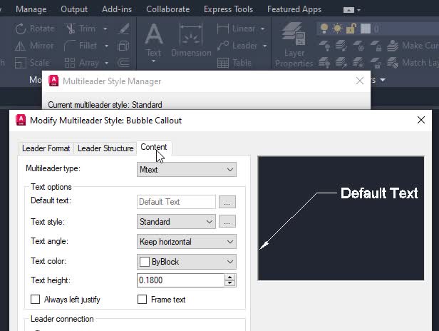

Create a Bubble Callout Style
  1. On the Home tab, click the Annotation drop-down panel and then click the third control in the list.
  2. In the Multileader Style Manager, click New (1), type Bubble Callout as the new style name (2), and click Continue (3).
  3. Next, click the Content tab (1), change the multileader type from Mtext to Block (2). For the Source Block, choose Circle (3). Then click OK.
  4. In the Multileader Style Manager, click Close.
    The new multileader style is automatically set to Current.
