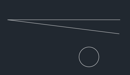

  1. Open a new drawing and draw two lines and a circle similar to what is shown.

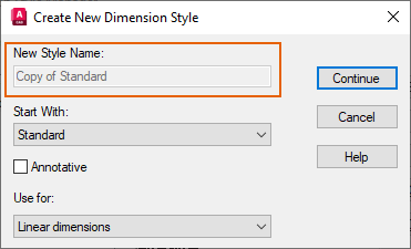

  4. Click New as if you want to create a dimension style.

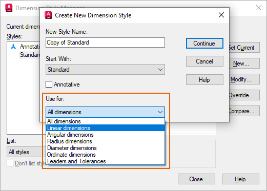

  5. In the Create New Dimension Style dialog box, click the Use For: drop-down list and select Linear Dimensions.
    Note: When you select a specific dimension type, the New Style Name text box is disabled since it is a substyle of the selected dimension style you started with.

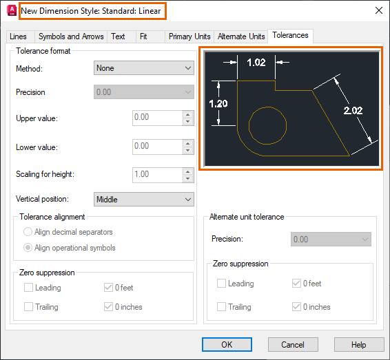

  6. Click Continue.
    The New Dimension Style dialog box opens. The title and the preview area indicate that it is a substyle of the Standard dimension style and that it will only apply to linear dimensions.
    Now you are ready to change the settings of the substyle. This substyle is used automatically when the main style, Standard, is current, and you create a linear dimension type.

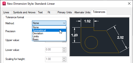

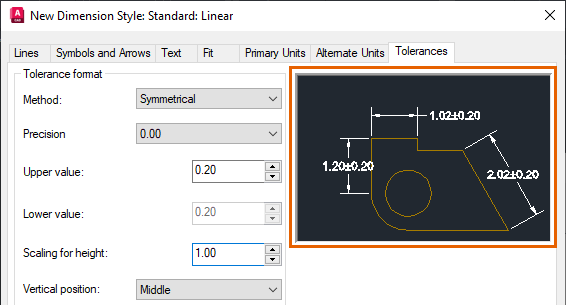

  7. Click the Tolerances tab.
  8. Select Symmetrical from the Method drop-down list.
  9. Enter 0.20 for the Upper Value.
    The preview area updates to display the tolerance on the linear dimensions.
  10. Click OK and Close to exit the Dimension Style Manager.

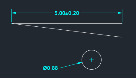

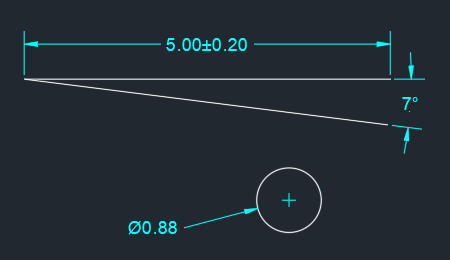

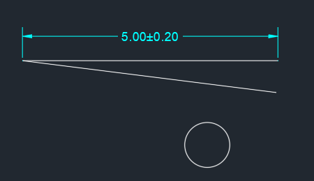

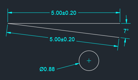

    Now it's time to add some dimensions to try the substyle. The current style is Standard, so any dimensions added will use that style, but only the linear dimensions should have the tolerance value.
  11. Click Annotate tab > Dimensions panel > Dimension. Find
  12. Select the horizontal line and place the dimension.
    Note: If you don't press Enter, you can continue selecting objects to create more dimensions.
  13. Select the circle to place a diameter dimension.
  14. At the Command prompt, enter A to add an angular dimension. Select the two lines.
  15. Select the other line to add another linear dimension and place the dimension, then press Enter to exit the DIM command.
    Even though all dimensions use the same style, only the linear dimensions include the tolerance.

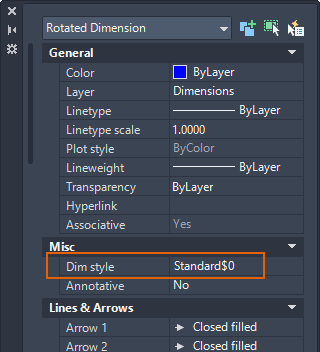

  16. Select one of the linear dimensions, right-click, and select Properties.
    The dimension style is shown as Standard$0 since it is a substyle.

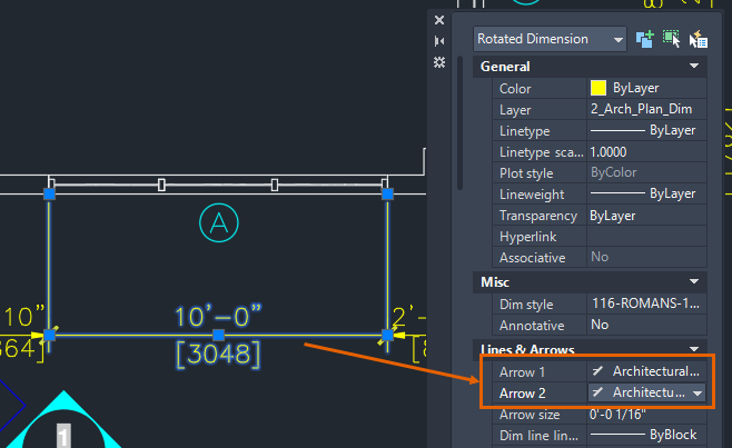

Before we talk about dimension style overrides or substyles, let's look at the simplest way to override a dimension object's settings. In this example, we'll change the properties of an existing dimension. These changes apply only to the selected dimension and don't change the dimension style itself.
  1. Open the sample drawing Wall Base.dwg which can be found at C:\Program Files\Autodesk\AutoCAD <version number>\Sample\Sheet Sets\Architectural\Res.
  2. Select an existing dimension, right-click, and select Properties.
  3. Change any of the properties for the dimension. For example, change the arrow style to Architectural Tick.
  4. To revert the dimension to the properties of its dimension style, select the dimension, right-click, and select Remove Style Overrides.

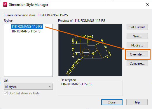

  2. Click Home tab > Annotation panel (expanded) > Dimension Style. Find

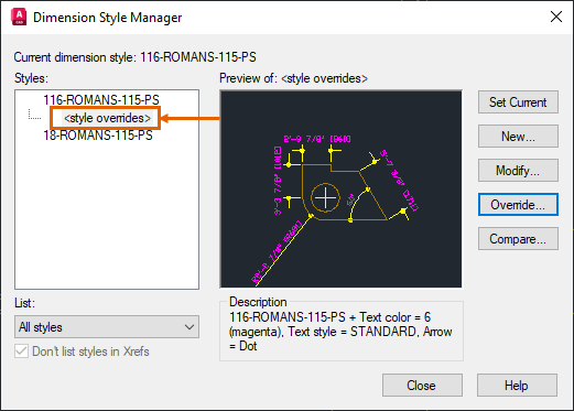

  3. In the Dimension Style Manager, select the 116-ROMANS-115-PS dimension style and click Set Current.

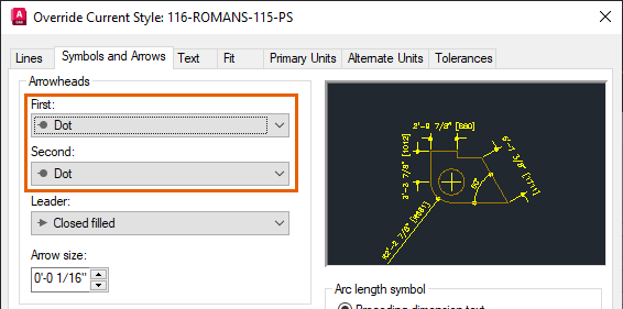

  4. Click Override.
  5. In the Override Current Style dialog box, click the Symbols and Arrows tab.
  6. Select Dot from the First arrowhead drop-down list. The Second arrowhead automatically changes to Dot to match the First arrowhead.

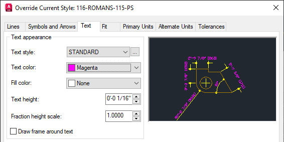

  7. Click the Text tab.
  8. Change the text style to Standard and the text color to Magenta.
    The preview area updates to show the new settings.
  9. Click OK.
    The Dimension Style Manager indicates that the style has overrides.
  10. Click Close.

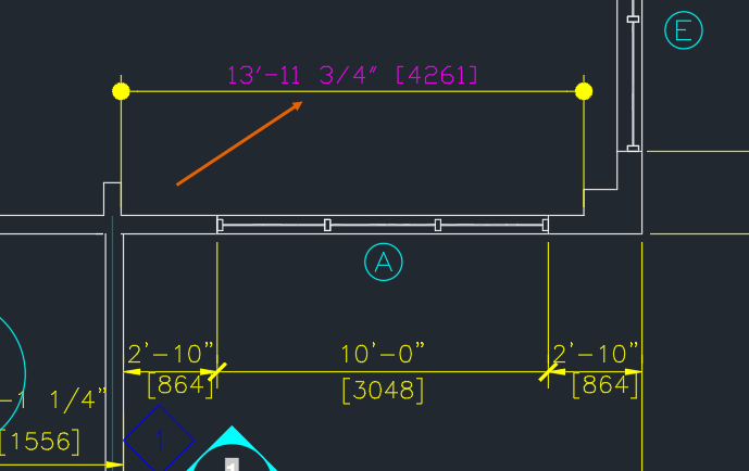

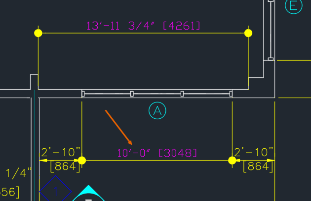

  12. Create a dimension somewhere in the drawing.
    The dimension uses the override settings for the current dimension style defined in the Dimension Style Manager.

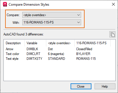

To help understand the differences between a style and its style overrides, use the Compare function in the Dimension Style Manager.
  1. Click Home tab > Annotation panel (expanded) > Dimension Style. Find
  2. Select either the 116-ROMANS-115-PS dimension style or the <style overrides> below it.
  3. Click Compare.
    The Compare Dimension Styles dialog box opens.
  4. Make sure you compare the <style overrides> with 116-ROMANS-115-PS. If necessary, change the selections in the drop-down lists.
    The differences are shown in the lower half of the dialog box.
Note: You can use Compare to see the differences between any two dimension styles. Simply select the dimension styles from the drop-down lists that you want to compare.

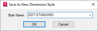

Save Overrides as a New Dimension Style
There might be times when you want to save the overrides as a new, separate dimension style.
  1. Select one of the dimension objects that has overrides. The overrides can be from property updates on the dimension, or a dimension inserted with dimension style overrides.
  2. Right-click and select Dimension Style > Save as New Style.
  3. In the Save As New Dimension Style dialog box, enter a style name.
