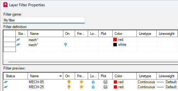

Create a Layer Property Filter Based on Layer Properties
  1. In the Layer Properties Manager, click New Property Filter.
  2. In the Layer Filter Properties dialog box, enter a name for the filter.
  3. Under Filter Definition, specify the layer properties as follows:
    • To filter by the layer name, enter text along with wild-card characters such as * under the Name column.
    • To filter by a property, click in the column for the property, and choose a setting.
    • To filter using multiple properties, click each property in a single row in the filter definition.
    • To filter using more than one value for a property or more than one set of properties, choose other values in the next row.
Note: The settings in a single row represent a logical AND, while the settings in multiple rows represent a logical OR.
In this example, the layer property filter includes layers that start with "mech" and are red or layers that start with "mech", are off, and white.

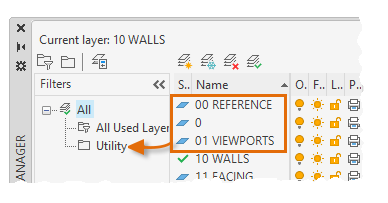

Create a Layer Group Filter by Selecting Layers
  1. In the Layer Properties Manager, click New Group Filter.
  2. Enter a name for the layer group filter.
    Since the new, empty filter is selected, no layers are shown in the layer list.
  3. In the Filters panel, click All or one of the other filters to display layers in the layer list.
  4. Drag the layers from the layer list to the layer group filter.
    This group filter saves a subset of the list of layers. When you choose a layer group filter, only the specified layers are displayed in the layer list.
In this example, I am creating a layer group filter called Grounds, and dragging the TREES, LANDSCAPE, and LAKE layers into the group filter.
