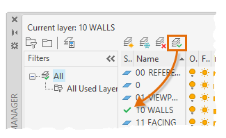

Use the Layer Properties Manager to manage your layers. Find
  • Create, rename, and remove layers
  • Set the current layer on which new objects are automatically created
  • Specify the default properties for objects on the layer
  • Set whether the objects on a layer are displayed or turned off
  • Control whether objects on a layer are plotted
  • Set whether a layer is locked against editing
  • Control the layer display properties for layout viewports
  • Sort, filter, and group layer names

Current Layer
All new objects are drawn on the current layer by default. The green check mark on the Layer Properties Manager indicates the current layer.
