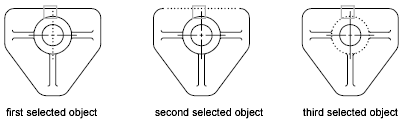

It is difficult to select objects that are close together or lie directly on top of one another. The example shows two lines and a circle that lie within the pickbox.
If selection preview is turned on, you can cycle through the objects by rolling over the object on top to highlight it, and pressing and holding Shift and then pressing Spacebar continuously. When the required object is highlighted, left-click to select it.
If selection preview is turned off, hold down Shift+Spacebar and click to cycle through these objects, one after the other, until the one you want is selected. Press Esc to turn off cycling.
