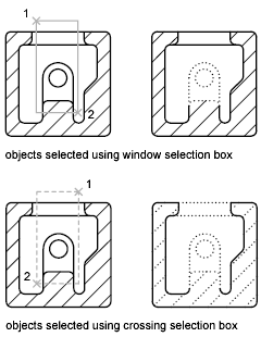

Specify a Rectangular Selection Area
Specify opposite corners to define a rectangular area. The background inside the area changes color and becomes transparent. The direction that you drag your cursor from the first point to the opposite corner determines which objects are selected.
  • Window selection. Drag your cursor from left to right to select only objects that are entirely enclosed by the rectangular area.
  • Crossing selection. Drag your cursor from right to left to select objects that the rectangular window encloses or crosses.
With a window selection, usually the entire object must be contained in the rectangular selection area. However, if an object with a noncontinuous (dashed) linetype is only partially visible in the viewport and all the visible vectors of the linetype can be enclosed within the selection window, the entire object is selected.

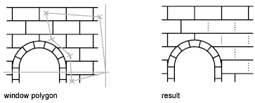

Specify an Irregularly Shaped Selection Area
Specify points to define an irregularly shaped area. Use window polygon selection to select objects entirely enclosed by the selection area. Use crossing polygon selection to select objects enclosed or crossed by the selection area.

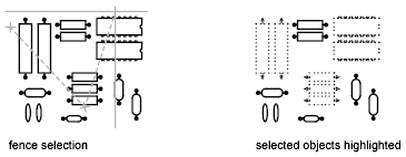

Specify a Selection Fence
In a complex drawing, use a selection fence. A selection fence looks like a polyline and selects only the objects it passes through. The circuit board illustration shows a fence selecting several components.
