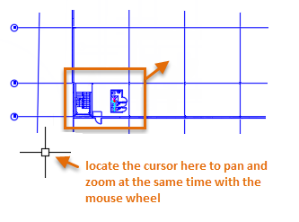

Here's how you can reduce the need for panning by combining panning and zooming.
  1. Locate the cursor to the outside of the area that you want to center.
  2. Scroll the mouse wheel to zoom in.
This technique moves the area of interest toward the center of the drawing as you zoom in.

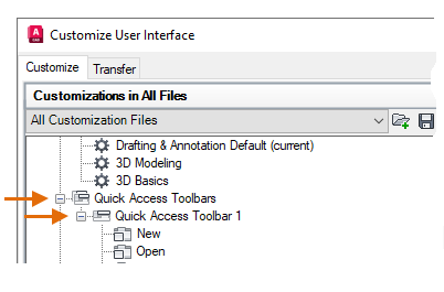

  1. Enter CUI at the Command prompt to display the Customize User Interface Editor.
  2. Expand the Quick Access Toolbars node as shown.

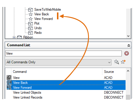

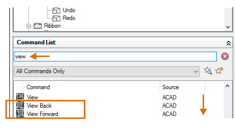

  3. Enter "view" in the Command List Search box and scroll down the list about half way until you see the View Back and View Forward items.
  4. Shift-select and drag both the View Back and View Forward commands to just above Plot.

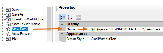

  5. Copy and paste the following macros into the Name field for each of them when you click the control in the CUI under Quick Access Toolbars:
    • $(if,$(getvar, VIEWBACKSTATUS),,~)View Back
    • $(if,$(getvar, VIEWFWDSTATUS),,~)View Forward
    For example, here's what the properties of View Back should look like:
    These two macros gray out the View Back and View Forward buttons once you reach the beginning or end of the previous views.
