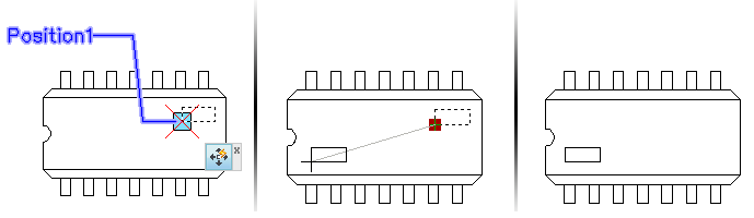

Apply a Move Action to a Point Parameter
A move action associated with a point parameter moves all objects in a selection set in any direction. The point parameter is the location of the grip for the move action in the block reference.

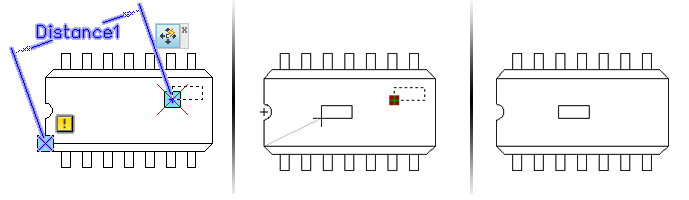

Apply a Move Action to a Linear Parameter
A move action associated with a linear parameter moves all objects in a selection set only in the direction of the linear parameter. The parameter key point is the location of the grip in the block reference.
