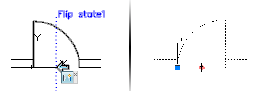

A flip action mirrors selected objects in a dynamic block reference about a specified reflection line.
A flip action is always associated with a flip parameter.
