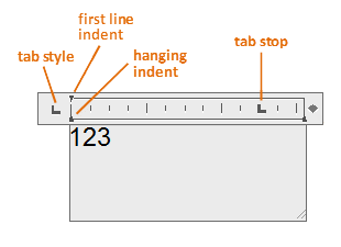

Set Indentation and Tabs
  1. Double-click the multiline text object.
  2. Select the paragraphs that you want to indent.
  3. On the ruler, slide the top indent marker to where you want the first line of each paragraph to start.
  4. Slide the bottom indent marker to where you want the other lines of each paragraph to start.
    This step indents turnover lines in paragraphs that are more than one line long.
  5. To work with tabs, select the paragraphs you want to change, and do any of the following:
    • Style. Click the tab style until the tab type you want is displayed.
    • Insert. Click the location on the ruler for the new tab.
    • Move. Drag an existing tab to a new location on the ruler.
    • Delete. Drag a tab off the ruler.
    Note: Right-click in the editor and select Paragraph to specify indentation and tabs on the Paragraph dialog box.
