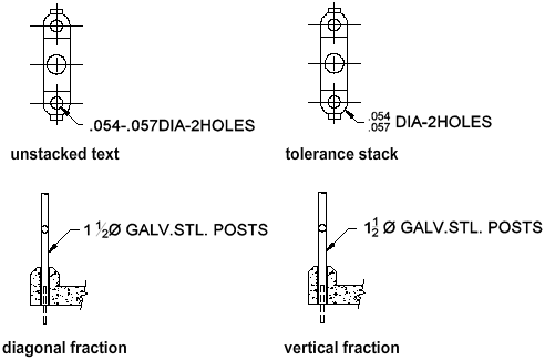

Stacked Characters
Stacked text refers to the fraction and tolerance formats applied to characters within multiline text objects and multileaders. Characters representing fractions and tolerances can be formatted to conform to several standards.
You use special characters to indicate how selected text should be stacked.
  • Forward slash (/) stacks text vertically, separated by a horizontal line.
  • Pound sign (#) stacks text diagonally, separated by a diagonal line.
  • Caret (^) creates a tolerance stack, which is stacked vertically and not separated by a line.
By default, numeric characters entered before and after a forward slash, pound sign, or caret stack automatically. For tolerance stacking, the plus sign (+), minus sign (-), and decimal point (.) also stack automatically.
