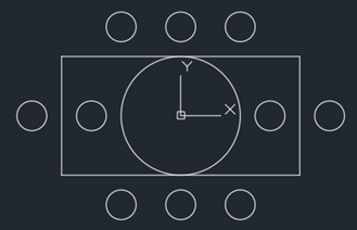

  1. On a blank drawing, draw the geometry to represent the round table and 4 chairs. The chairs don't have to be fancy, they can be simple circles. Place the center of the circle at 0,0.
  2. Draw the geometry for the rectangular table with its center also at 0,0. Copy the chairs so you have 8 around the rectangular table. It's ok if some of the geometry is used in both configurations, such as a couple of the chairs.

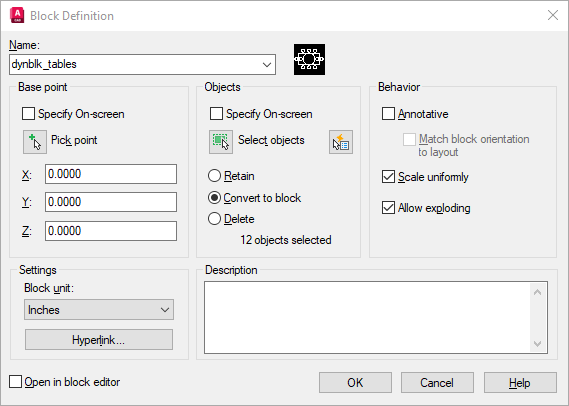

  3. Click Insert tab > Block Definition panel > Create Block. Find
  4. Name your block and select all the geometry and click OK.

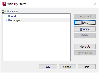

  5. Click Block Editor tab > Visibility panel > Visibility States. Find
  6. On the Visibility States dialog, you'll create two states, one for the round table and another for the rectangular table.
    1. Click Rename and enter Round to rename the default state.
    2. Click New, enter Rectangle, and click OK on the New Visibility State dialog to create the second state.
    3. Click OK to exit the Visibility States dialog.

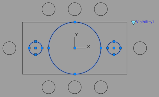

  7. Select Round from the drop-down list.
  8. Select all of the objects that are not part of the round table configuration.
  9. Click Block Editor tab > Visibility panel > Make Invisible. Find

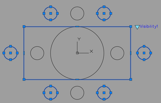

  10. Select Rectangle from the drop-down list.
  11. Select all of the objects that are not part of the rectangular table configuration.
  12. Click Block Editor tab > Visibility panel > Make Invisible. Find
