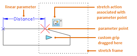

In a block definition, actions and parameters provide rules for the behavior of a block once it is inserted into the drawing.
In general, you first create a parameter and then you associate an action to that parameter. A parameter is represented as a parameter point with one or more custom grips that display when the block is inserted into the drawing and selected.
Note: When a yellow box with an exclamation point appears in the Block Editor, is usually signifies that a parameter does not have an associated action yet.
When you insert the dynamic block in a drawing and manipulate one of its custom grips, the associated action determines what will change in the dynamic block. Just as with parameters, actions can be changed using the Properties palette from within the Block Editor.
