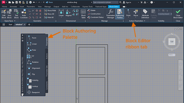

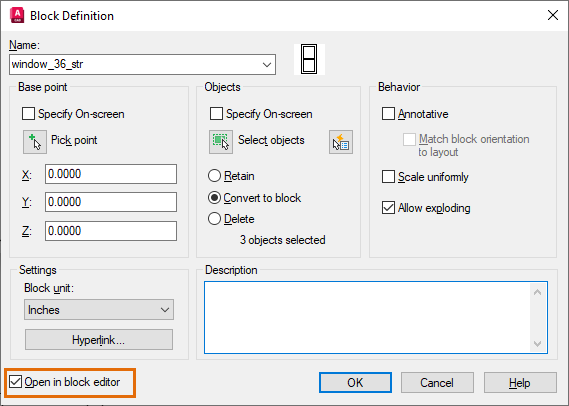

Create a Block
  1. In a blank drawing, draw a 36x72 rectangle to represent the window. Draw the inner rectangles as shown. Place the lower-left corner of the window at 0,0. This location will be used as the block's base insertion point.
  2. Click Insert tab > Block Definition panel > Create Block. Find
  3. Enter a block name. Use a name that indicates the block's use.
  4. Click Select Objects.
    The dialog box closes temporarily so you can select the objects.
  5. Select the objects drawn to represent the window and press Enter.
    The dialog box reopens.
  6. Check Open in Block Editor.
  7. Click OK to close the dialog box.
    The Block Editor environment opens and the Block Editor ribbon tab displays.
  8. If the Block Authoring Palette is not open, click Block Editor tab > Manage panel > Authoring Palettes. Find

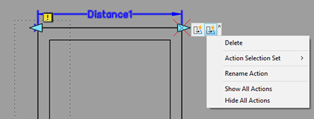

Add the Action
Parameters are used to get input from the user, but without an action a parameter doesn't do anything. For our window example, a stretch action will allow us to stretch and move geometry based on the properties of the linear parameter.

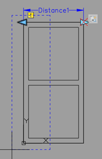

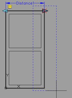

  1. On the Block Authoring palette, click Actions tab > Stretch.
    Follow the prompts on the command line:
  2. Select parameter: Select the Distance1 parameter.
  3. Specify parameter point to associate with action or enter [sTart point/Second point] <Start>: Specify the point at the right parameter grip (a red X appears when you move your cursor near it).
  4. Specify first corner of stretch frame: Pick above and near the center of the window, as shown.
  5. Specify opposite corner: Pick below and to the right of the window, as shown.
  6. Select objects: Use a crossing-window to indicate the entire right half of the window, then press Enter to finish object selection.
    An action icon is shown next to the parameter grip it is associated with.
    The block is now ready to use, but let's test it first.

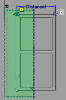

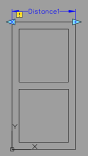

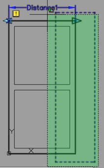

Stretch Both Sides from One Linear Grip
Now let's say you want both sides to stretch simultaneously when you drag the right grip. This can be done by adding another stretch action to the same linear parameter. This action will apply to the other side of the window. Start with the dynamic block you created previously.
Note: You could move all the geometry over to the left 18" so that 0,0 is at the midpoint of the bottom line of the window. This would keep the block centered around its insertion point when stretched. However, these examples show the insertion point in the lower left.
  1. Select the block, right-click, and choose Block Editor.
  2. On the Block Authoring palette, click Actions tab > Stretch.
  3. Select parameter: Select the Distance1 parameter added previously.
  4. Specify parameter point to associate with action or enter [sTart point/Second point] <Start>: Pick the same parameter grip as before.
  5. Specify first corner of stretch frame: Pick above and near the center of the window, as shown.
  6. Specify opposite corner: Pick below and to the left of the window, as shown.
  7. Select objects: Use a crossing-window to indicate the entire left half of the window, then press Enter to finish object selection.
    We actually want the objects to stretch in the opposite direction from the objects on the right side, for example when the grip is dragged to the right the objects stretch to the left. Do define this, modify the Angle Offset property of the action as shown.
  8. If the Properties palette isn't open, click View tab > Palettes panel > Properties. Find
  9. Click the stretch action icon you just added so that its properties are shown in the Properties palette.
    Note: Make sure that Stretch Action is shown as the object type in the Properties palette.
  10. Set the Angle Offset to 180 on the Properties palette. This causes the selected objects to stretch in the opposite direction when you drag the linear grip.
  11. Test the block as described previously.
