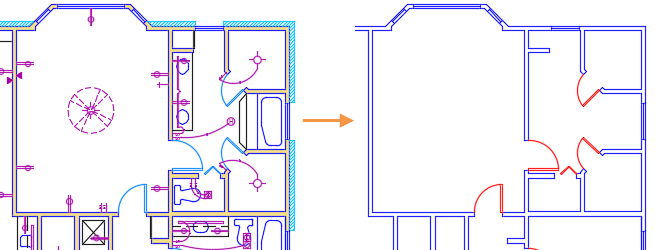

You can save your current layer settings as a layer state which you can restore later or import to other drawings. A layer state is like a snapshot of the existing layers and layer settings at the time the layer state is created.
In this example, all layers except those for the walls and doors were turned off, and the color for the door layer was changed. With layer states, you can save sets of layer settings and easily switch between them.
When you restore a layer state, you can restore all the layer settings or specify which layer settings to restore. For example, you can choose to restore only the Frozen/Thawed setting of the layers in a drawing, ignoring all other settings saved in the layer state. If a layout viewport is current when the layer state is restored, any viewport overrides are applied to this layout viewport.
