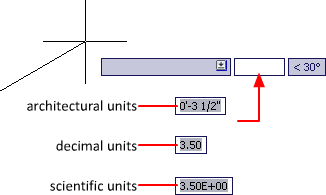

You can choose from several common conventions to represent the format and the precision of linear distances and coordinates displayed in the Properties palette, dynamic input, the status bar, and other locations.
For example, here are three variations of dynamic input.
