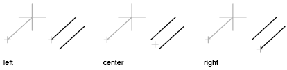

Using a Dragline to Control Double Line Placement
The dragline is a rubber-band line that determines the placement of a double line. You can control whether the double line is centered on or offset to the right or left of the dragline.
A negative offset value positions the offset side of the double line to the left of the specified points; a positive value positions the offset side to the right. Determine the left and right by imagining that you are standing at the start point of the line and looking at the endpoint.
