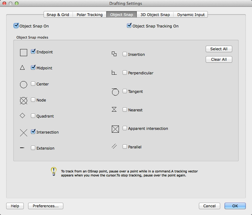

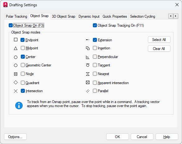

The following explain how to get and set the value of the OSMODE (Object Snap mode) system variable:
At the Command prompt, enter (setq cur_osmode (getvar "osmode")).
The current value of the OSMODE system variable is returned and assigned to the user-defined variable of cur_osmode. While OSMODE returns an integer value, the value is the sum of multiple "bit-code" values. For example, the value 35 indicates that the Endpoint (1), Midpoint (2), and Intersection (32) running object snaps are enabled.
At the Command prompt, enter osnap.
The Drafting Settings dialog box is displayed with the Object Snap tab current. This tab allows you to see which object snaps are enabled. The following image shows what the Drafting Settings dialog box looks like when the OSMODE system variable is set to a value of 35.
Drafting Settings dialog box - Windows
Drafting Settings dialog box - Mac OS
In the Drafting Settings dialog box, change which object snaps are current and click OK.
At the Command prompt, enter (getvar "osmode").
The current value of the OSMODE system variable is returned.
At the Command prompt, enter (setvar "osmode" cur_osmode).
The value of the OSMODE system variable is restored to the value that was previously assigned to the user-defined variable cur_osmode.
Display the Drafting Settings dialog box again. You should see that the object snap settings have been restored.
