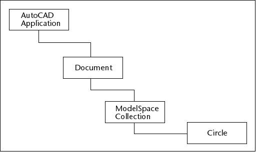

The hierarchical path traversed in the AutoCAD object model is pictured below:
