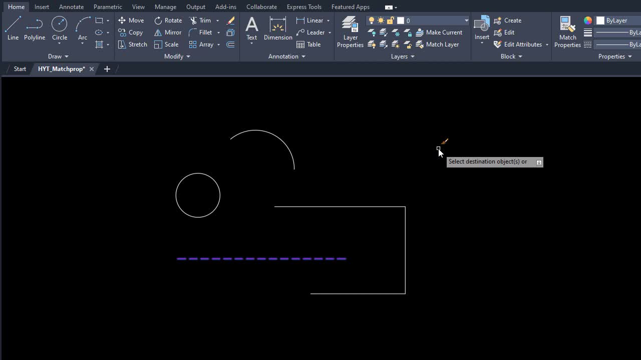

Copy Properties - Settings
Remember the settings option mentioned earlier in this article? For this example, I'll copy properties from a line to a variety of other objects and use the settings option to limit the properties copied.
  1. Open a drawing of your own or create a drawing with various geometry such as lines, circles, arcs, and polylines.
  2. Change the color of one line to Magenta, linetype Hidden, linetype scale 2.0, and a layer other than 0. We'll use this line as the source object.
  3. Click Home tab > Properties panel > Match Properties. Find
  4. Select the line object as the source object.
  5. Enter S to select which properties will be copied to the destination objects.
    Some things to note about the property settings:
    • Basic properties are common across all objects.
    • The source object's basic properties are shown in the dialog box.
    • Special properties are properties that are unique to that object type and are applied when the source and destination objects are the same object type.
    Note: In this example, we'll use the Basic Properties. In the next section, we'll look at the Special Properties.
  6. Clear the Color and Layer properties and make sure Linetype and Linetype Scale are selected.
  7. Click OK to exit the Property Settings dialog box.
    Note: The settings are persistent across AutoCAD sessions.
  8. Select the destination objects.
  9. Press Esc or Enter to exit the command.
    Notice that layer and color were not copied to the destination objects.
