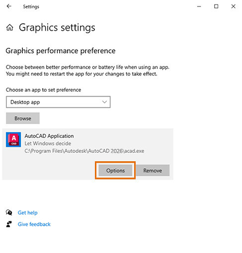

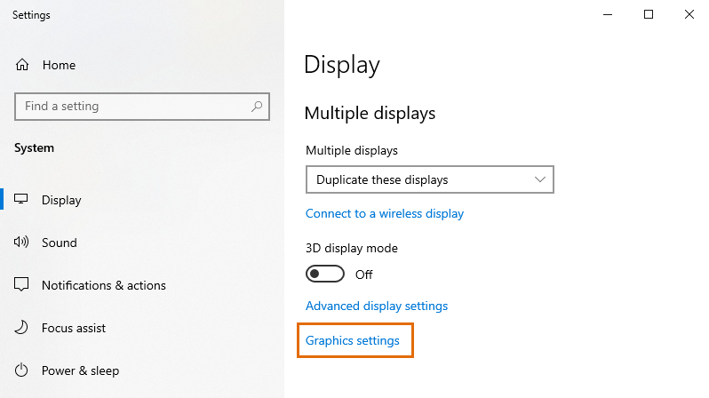

Windows 10
- Right-click the desktop and choose Display settings.
- Scroll down and click Graphics settings.
- Click Browse and then navigate to and select the software executable. As an example, for AutoCAD 2026, this would be C:\Program Files\Autodesk\AutoCAD 2026\acad.exe. Double-click acad.exe to add it to the list.

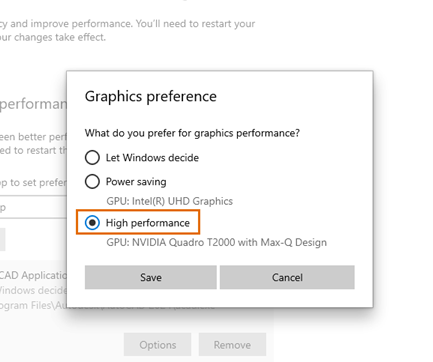

- Click the AutoCAD application, then click Options.
- Select the High-Performance option, then click Save and close the Settings panel.
- Restart AutoCAD if it was running.

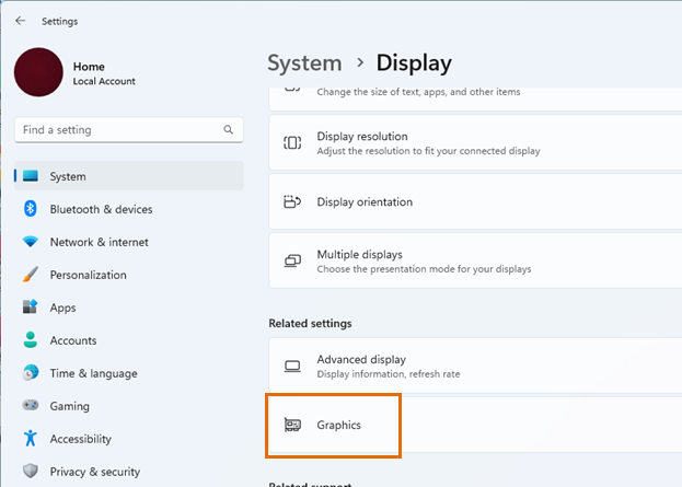

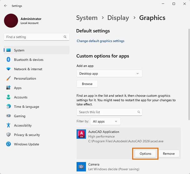

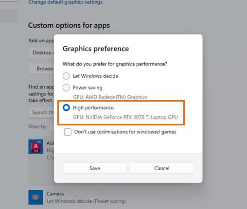

Windows 11
- Scroll down and click Graphics.
